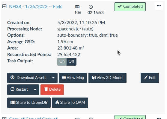

So how does it work and how does it look? Initial test indicate that it is much faster. Depending on your machine and dataset, you might see 4-6 times faster. And the results for flat areas are quite suitable. I’m even pleased with trees (from an appropriate high-enough height, anyway).
There will be artifacts. That is the trade-off. But, if it’s an acceptable trade-off, if you need a good-enough solution fast, this might be the setting for you:
